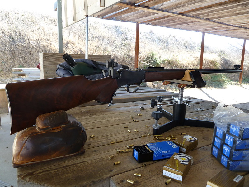

I'm using iron sights instead of a scope of course, but this target was shot at 300yds, using Eley Team, and 73 minutes of elevation from the 50yd zero. Below are the rifle and 50 and 100yd targets.
