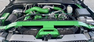

Back years ago, 60's, we'd go to the drags and loved boat races, and the dirt track races at Ascot Park. One friend had a super stock Dodge he raced. The guy I rode and built bikes with raced TT on a Triumph. We did a lot of street hotrodding and stupid things on them in the late 60's. Those were thee days. Still have that bike. My only times on a strip were back when there was one in Salt Lake City (now long gone). Just to see what the Duramax would do.
Very built engine, money pit, went pretty good, 10.97, back in 2012. Today just a daily driver and hunting truck with a very occasional street go. There's no strip around here anymore and I'm just too old for that stuff anyway. The bike as it was back then, the truck as it is now.
