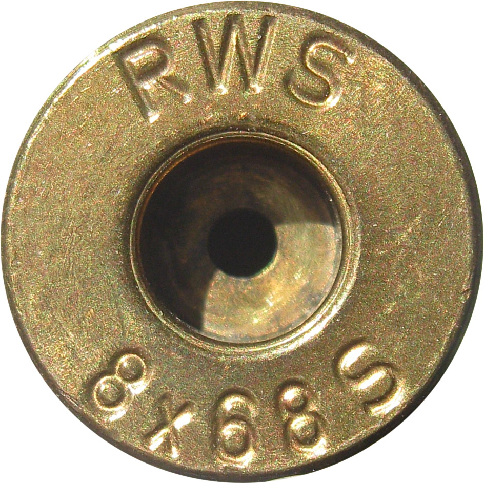

I have a 98 in 8x68 Shuler out in the gun room, along with factory ammunition if anybody wants to buy it.
