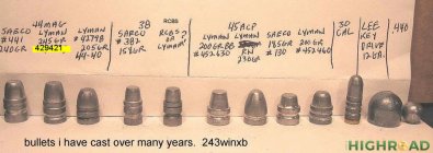

Shoot cast in 30/30, 300 Savage, 308, 30/06, 300BO, 30/40 Krag. The Saeco 315 bullet or the RCBS 308-165 can be made to shoot without too much problem. Older wheel weights (new ones are useless), add a little tin (2%) to get the mold to fill out. Cast them hot enough to get good bullets, frosty ones work just as well as shiny ones. Use gas checks and a quality lube. Size them .001-.002 over bore and load them as long as possible. 2400 powder works well as long as your not shooting over 1600-1800fps. If you want more velocity use a slower powder. Like all loads start at the bottom and work up from there. Attached is a picture, 308, 311284 bullet, prone with sling and scope, 10 shots @ 100yds. They can be made to shoot, just takes experimenting and the willingness to stay with the endeavor.
