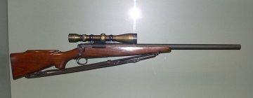

The first US marked rifles were from the Remington factory. They had heavy 40X barrels. Used stripper clips, only the .308 receivers were factory-slotted for clips. Drilled & tapped for iron sights.The holes may have been covered by the wood stock on some early models.
The serial number is odd, starting with a 0 (zero)? The 5 digit guns didnt have the 0, that i seen online?
When the USMC started making their own, using, as marked, Remington 700 actions, they installed 25" lighter tapered barrels.
My guess....
The term M40 gets thrown around and gets confused. Remington made a Model 40, and the USMC has a Remington Model 700 designated as an M40. There is a big difference between a Remington Model 40X and a USMC M40. There is a small serial number range for USMC M40's that were 6 digit SN, with an even smaller number of 7 digit SN. also there is a very specific type of cut to the receivers, rear stripper-clip slot, right side thumb cut out, left side lowered, and bullet nose cut at the front, that make a "USMC spec M40 receiver" there is more to it than a stripper-clip cut and rear sight holes. 40X target rifles will not have all the cuts, usually just the stripper clip cut and thats it, and not all of them will even have that (A lot of older M700's also had a broach cut and not an actual stripper clip slot that gets confused with the latter as well) There are a lot of US marked Remington 40x's that were probably just used by the teams for target rifles, does not mean they were sniper rifles. The USMC M40 Rabbit hole is a deep one. Here is a good place to start SnipersHide post. Its more of a how to clone one but there is some good information in there, and will take you on your journey. It gets even better when you start down the M40A1-5 rifles. (and way more expensive... Just saw an original "return" M40A1 McMillan stock sell for $5000, and there's another on eBay now for $4999, and McMillan makes "new" ones for about $1000 or so if you get all the options.)
Without seeing any pictures of the receiver, Id say you have a Remington 40X that was marked for the US military and was most likely intended for use as a Target rifle for one of the Teams, and not a USMC M40 Sniper rifle. Doesn't mean its not rare or valuable, however.
ETA: I have a friend that is super big on cloning all sorts of rare Military rifles, and has access to resources beyond anything I have ever seen. I have done some builds for him in the past on original parts he sourced etc of some one off experimental rifles built at Crane, etc so if you can send me some pictures I can get them to him and he would probably know or can find out exactly what that is.
My barrel is .830 at the muzzle and 26" total length. Somebody mentioned the amount of serial numbers-it is posted above. Another thing mentioned was the distance of the US and serial number below the US. Mine is only about .030" below the US.
USMC M40 would have a 24 in barrel. Later M40A1-5 are 25, (24 measured from the recoil lug.. Marines do weird stuff)
exactly... weird marine stuff. But a M40 is a true 24 in breech to muzzle and not measured the weird way like the A1's etc.
