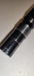

How do you remove the barrel?
It is pined in from under the receiver into a blind hole(pin has to come out the way it went in) .

Aren't 54.30 barrels threaded? Match 54 (14xx, 16xx, 17xx, 18xx, and 19xx) barrels are pinned. Diagrams of the 54.30 tenon show a relief slot for a set screw, but that's not a pin.
I don't know what was the reasoning but what a PITA to deal with.

Unless I'm mistaken, the separate barrel face means Anschutz don't have to time the extractor slots. And it allowed Anschutz to say their new 54.30 has a chamber like a Bleiker.
very unlikely they would say it is similar to another manufacture's barrel. the floating breech means you could in theory swap barrels around and not have to worry about extractor timing.
