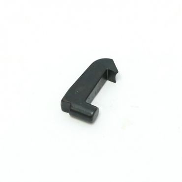

My Anschutz 1964 Match 54 model 1411 serial number 40250 has a single extractor and ejects properly about two out of three times. The chamber, including the extractor groove, and the bolt have been cleaned on multiple occasions. I believe the corner of the extractor has been worn and requires replacement, but I cannot find a schematic or part number for the extractor or spring. Information related to dual extractors is overwhelming, but I think I found the correct part at https://www.ultimate-gear.be/en/Anschütz-gun-manufacturer/anschutz-extractor.
Could someone help out with a schematic, part numbers, or replacement method?

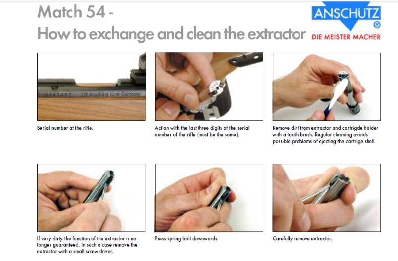

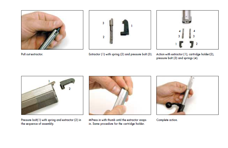

Your 1963 or 1964 Anschutz, which appears to be a Model 1413, may only need a good cleaning of the extractor area of the bolt. This involves removal of the extractor.
As a side note, only parts of the stock are shown making a more accurate identification difficult. Why do you say the stock and trigger are not original?
What's shown below is specifically for the post-1964 Match 54 models which had a cartridge retainer in addition to the extractor. Nevertheless, the instructions should be good for the single extractor rifles.
While parts lists are not always easily found for the older models, the extractor used with later ones are likely identical. They should be found at Anschutz dealers. The part is 1404-7.

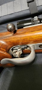

The trigger, the blade at least, is the current standard 7434, for a 50xx trigger. Either it's been retro-fitted to a 14xx trigger, or a 50xx trigger has been retro-fitted to the action.

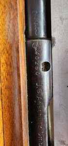

Thanks to all for the advice. I have added additional pics showing the trigger, model and year. Also, a Facebook post also thought the stock was a Freeland laminate, the same type that Winchester used for the 52 International.

Your trigger is the later 50XX series. These are nice light triggers.
Possibly, but it could be a 1970s 507x trigger. A true 5018 (as fitted to 18xx, 19xx, 20xx, and 54.30 rifles) isn't compatible with a 14xx bolt. Anschutz changed the geometry of the sear and firing pin bent for the 5018/18xx rifles. And an 18xx firing pin won't work in a 14xx bolt either.
At some point after introducing the 5018, Anschutz started building 5071 triggers on a 5018 frame, probably when they ran out of original 5071 parts. They continued with thus until about ten years ago.
The OPs trigger could be a fairly new 5071-1, or a 40+yo 5071, or 5072 (the version of the 5072 specifically meant for retro-fitting to older 54s). All we can say for certain is the trigger blade is fairly new, but this will retro fit to any 507x/5018/502x trigger, and that it's not a dedicated 507x single stage (variously catalogued as 5072D or 5075), as these had rhe first stage travel screw blanked off.
