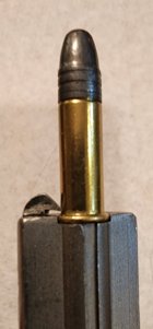

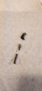

I could not withstand so many poor ejections and repositioning so I have disassembled, cleaned, and reassembled three times. I found some powder but not a lot.The first time I put it back together everything sprung apart and I had to find it. The second time it went together and clicked in place with too much gap from the ejector to the bolt. The third time was the same. I have been assembling with the spring to ejector adapter positioned as shown. Is there a way to adjust the Gap so the ejector is clamping the shell rim? Should I rotate the adapter 90° from the attached image?
I replied to your PM send me an email. the angle of the tip of the claw needs to be angled downward. as you see in your picture it is pushing against the side of the case it should be pushing down on the rim. as you can see how easily the rim can jump the bolt face cut and fall off the claw. this why they added the shell holder to solve this problem if the claw was not a perfect fit after assembly.

A huge shoutout to Hi-NV Shooter for helping with new parts and instructions. I replaced the extractor, adapter, and spring. I believe the new spring and increased clamping force was the major fix, and a good cleaning can never hurt.

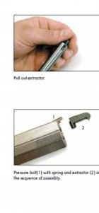

As Tim stated, not really difficult I do suggest using a clear plastic bag big enough to fit the bolt and your hands to keep anything from flying into never-never land. reassembly is very easy.
Lee
