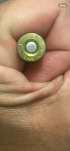

That case appears to have a LOT of taper. Much more than a .243 would have.
Think its just the picture or the way it was taken, I was actually thinking the same thing when I looked at the post.
Pics below are unsized SLR cases and then one next to a sized 22-250
@urbanrifleman im unsure, ill have a look at the reamer specs or the QuickLoad file I build when I took all the measurements. Should be around .322” odd something
