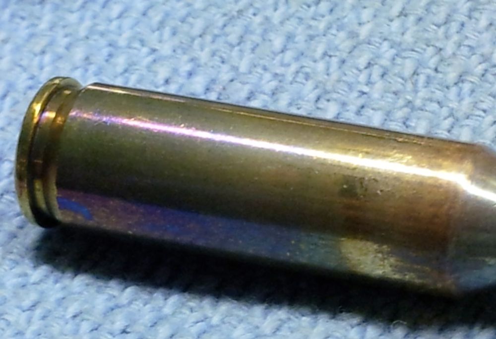

But color can be deceiving - the cases on the right were annealed at the same time as the ones on the left, at the same temperature, for the same duration, but the ones on the left look like Lapua's annealing, the ones on the right have a silverish colour - the difference is that one group was made ~10 years earlier than the other - both are the same make.
The distance that colour travels on the case body can be deceiving... the case shown here would be thrown away by most everyone...
When it was annealed, a strange thing happened. It annealed in the flame normally, and and when dropped on the foil, it looked normal, and it lie there for a few seconds, then the dark "annealing colours" started running up the body to the head, like a fast burning fuse.
But when tested for hardness, the case head hardness had not been changed, and the case was fine to load.
You can see the indentations in the case head of both cases (low and on the right side of the case head - you might have to look hard).
Tested @ 0.0625x100Kg
