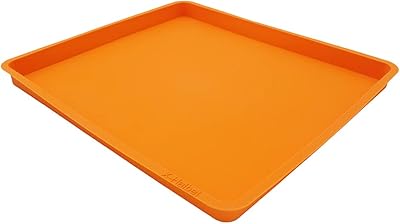

In case anyone is looking for the perfect landing zone for their brass when it's outfed by the annealer, I use a silicone baking tray 9x12". Also known as a swiss cake roll mat. The raised edges are the key. I already had it for lubing cast bullets. So it was a natural fit.
X-Haibei Swiss Roll Cake Mat Flexible Baking Tray Silicone Cookies Mold L10 W11inch H 0.78inch
