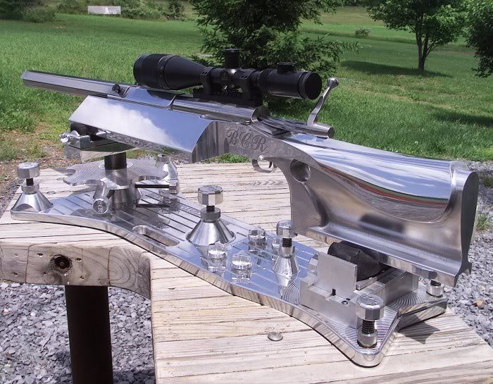

This was made by Bruce Baer as stated in the article from Accurate Shooter. Here is the other side:
Here is the link:
http://www.6mmbr.com/gunweek057.html

If you're asking about the stock in the photograph, I don't know. I posted this as an example.
