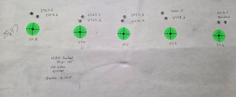

Finally got around to the tuner test with the 135 gr. Berger LRHT bullets today. Setting 10 was middle ground for this load. Verifying two groups back to back in the ones. Chrono #s are fantastic for this load. I think it is ready for 300 and 600 yd. checks.
135 GR. BERGER LRHT 2.131 O M 2.883 COL T/L B S .465 B C .650
POWDER VV-N540 38.3 GR. PRIMER CCI 450 .281 BU. T/S -10-
SEATED @ 2.124 O M 2.876 COL .007 OTL
Bill -
Howdy !
That looks REALLY good !!
Enjoying watching your progress on the project !
