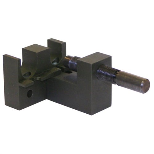

I have a Solus action and I need to disassemble/strip the bolt so I can get an accurate headspace measurement with a fire-formed cartridge for reloading purposes. Since the Solus is modeled after an AR-style bolt, it's more of a pain to take apart than I was hoping for but I'll get it worked out (I ordered the Brownell's extractor removal tool since the Sinclair does not work with this bolt due to the tri-lug). My question is regarding the extractor: Do I need to remove that too when I strip the bolt or just the firing pin and ejectors to check headspace? I am new to this but I am assuming you need the ejectors removed because they would create a false reading of the cartridge-to-headspace due to their protrusion from the bolt head, but would leaving the extractor in also affect this measurement?

Thanks for the reply!!! It’s a tri-lug bolt so it won’t fit into the Sinclair ejector removal tool, which I didn’t know until after I purchased it. I had read somewhere that they kept the same style dual ejectors that they use in there AR BCG’s, which is why I likened it to AR style bolt, that was my mistake with verbiage. Apparently a tri-lug bolt on a Rem700 footprint is rare. I think the Brownell’s will work better and will HOPEFULLY make removing the dual ejectors a little less painful.

You'll have to remove them to have any feel for the case size correctly and then touch with bullet. Getting them out is fairly simple if you use a large plastic bag and do it inside, should catch spring or plunger trying to exit the scene. Putting them back in, I had a rod 5" or so long that OD was very close to ID of bolt face and flat on end. I put it in bench vise and pushed bolt against it compressing springs of both ejectors simultaneously and put the pin back in. Those springs are begging for some tuning and weight reduction but wasn't my rifle and owner was fine with it. I'm assuming they had some ejection problems and why they went with what they did.

I’m hoping the Brownell’s tool will help with removal and re-installation of the ejectors.

They are not that hard to remove and install. I put them in one at a time and hold in place with a 1/16 drill bit. Put the pin in and drive it in. Not an issue.
If you’re worried about loosing anything. Just use the plastic bag n
Method. Put bolt in plastic bag and work through it. If something flys out it will be in the bag.
Where most people get into trouble is, They don't use a starter punch. Use a starter punch to get the pin moving and then follow through with the proper diameter straight punch.
If you have a vise with a wide enough throat, You can cut off a piece of alum rod close to the diameter of the bolt face and use it to compress the plunger/plungers if you don't have the proper tools.
