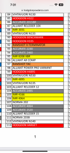

I've been debating the same for .223, 20 prac, 6.5 Grendel and a few other calibers but it seems all the data I find has all the VV powders shooting slow compared to other powders
Reactions: K22
In my use of N-135 and N-140 in my 6br with 64-75 gr bullets I find them both faster than the burn rate chart suggests. JMO
That applies to many Viht powders, especially the older products. I've found this with N135, N140, N150/550, and N160 in a wide range of applications. Some burn rate charts show N135 as 'slower' than both VarGet and H4895 which is nonsense in practice. (N135 is frequently shown too as only a hair 'quicker' than N140 - just look at Viht's maximum charges for the pair across a range of cartridges and bullet weights to see there is a considerable difference between them.)
N150/550 are shown as equivalents to the 4350s - they're not which is why the 'quicker' of the pair, N150, is widely used in 308 Win with charges very close to those for VarGet. N160 is frequently shown as equivalent to IMR-4831, whilst I and others find it closer to IMR-4350.
