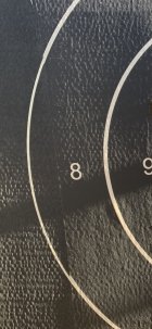

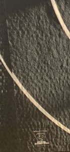

Here is a good example of what I am talking about.
A official NRA face. It’s pretty obvious the issue.
What if the person lined up the inside of the lines instead of the outside?? The lines from the reface target and original target aren’t even the same.
I have seen and have scored shots that are closer then that but this is one error I am talking about.

I never said anything about human error in scoring. Please re read it, but again, the error was induced when the target or face was put on. The next target puller doesn’t know so what they score is what they score but is it correct because of the paper?
If you truly measure the rings, you will see what I am talking about.
I knew what you meant and understand your concerns. Your observations regarding the potential scoring issues presented to (and by) human pullers are valid and are something that need to be considered and addressed whenever possible. However, I have seen numerous posts in the past by others advocating the use of electronic targets that would almost lead one to believe humans are barely even capable of providing fair scoring on pulled targets. I don't think the situation with pulled targets is nearly that bad, but I was not specifically replying to your statements, which is why I didn't directly quote your earlier post.
I've encountered the situation you illustrated more than a few times, myself. In the images you showed, it appears to be more than simple misalignment caused by re-facing the target. The scoring rings of the target face and the repair center actually appear to be of different width. Nonetheless, I still believe the human eye is more than capable of resolving such issues and providing a fair score to the shooter. I can only speak for myself, but in such a case I would still use the outermost edge of the scoring ring(s) where they were mis-aligned to judge. If there was any question at all in my mind, the shooter would receive the benefit of the doubt and get the higher score.
