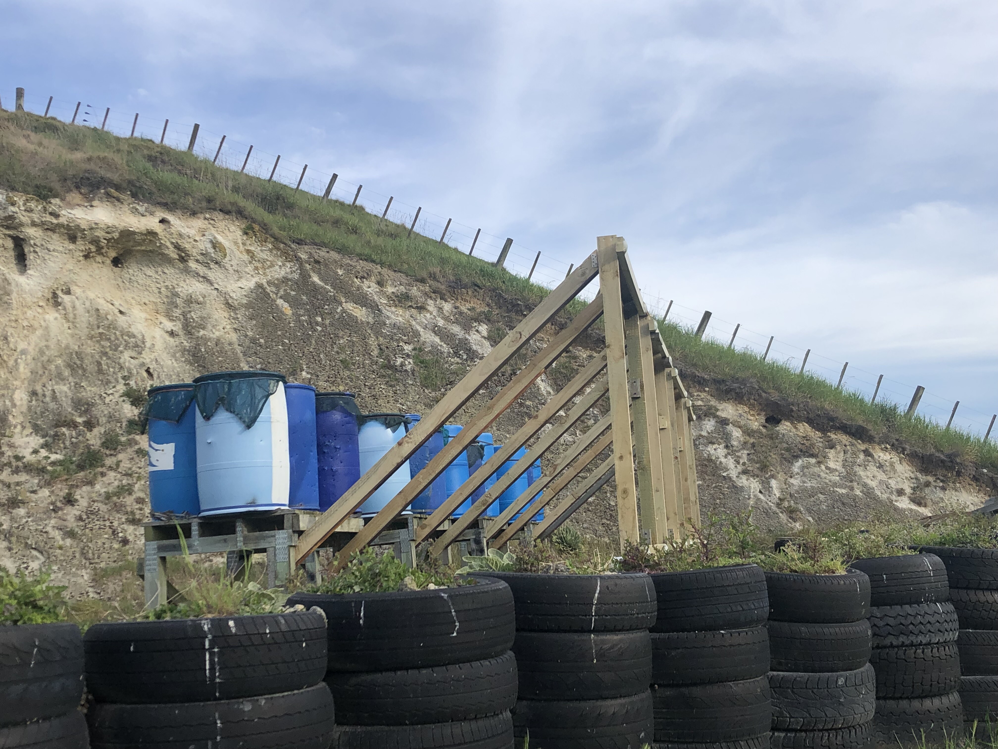

Most ET systems in NZ are SMT with a few SM around. As above, the mic mounting bases are permanently fixed to solid frames and the targets themselves slot into these frames. The targets themselves are effectively immobilized in their carrier frames so no movement/alignment issues there.
We recently fully rebuilt our four 3/600yd local target frames so I was able to check the mounting setout.
You can see the drums full of shredded car tyres that stop/collect the bullets. The range is on a farm so we need to avoid lead contamination.
