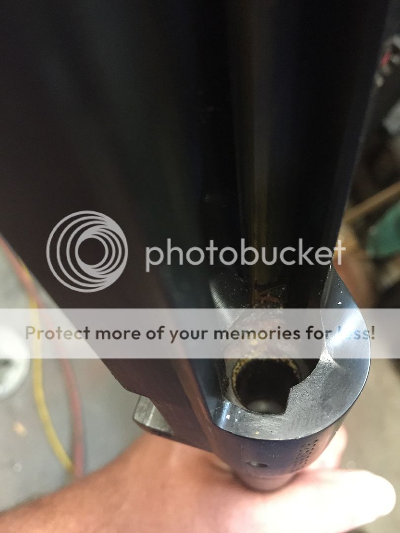

Here is a brand new model 70 straight off the brown truck from a distributor i got in a few weeks ago for a friend of a customer. 7wsm i believe. I got it in to mount a scope. When i opened the bolt it looked like hair growing off the end so i snapped this pic. This gun was unusable in its factory state due to poor quality control. That is bluing salts that were not neutralized. Instead of sending it back he just wanted a new barrel since he needed it to hunt. Sad sad day for winchester whoever they are these days.

Dusty, the Winchester rifles are covered by Browning Arms Company these days, and if you send a defective rifle to them, they will repair or replace. I bought a Win Mod 70 Extreme Weather a few years ago that had a ring in the neck, most likely caused by a chip getting caught on the reamer. Thought they would replace the barrel maybe, but instead they sent me a whole new rifle. I have 4 Winchester/ FNH Mod 70's and they all shoot very well for factory rifles, all are in 308W. I find it interesting that Winchester brand rifles use the MOA trigger, but FNH rifles use the old style Mod 70 trigger. IMO some of the best factory hunting rifles are the FNH PBR type rifles with DBM. they are rugged and work flawlessly.
That is my opinion as well joe. But deer season is a holiday around here so i had to act. He wanted a full custom eventually anyway he just got a winnie instead of a predator now
