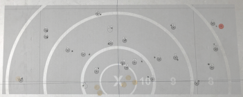

Below is a screenshot of a physical target laid over the shotmaker virtual target, this was shot at 1,000 yards in winds from 6-12MPH. If you were to test this out at distance I would imagine you would find similar results, my frame is 4 foot square and made with kiln dried 2x4's with glued and screws half-lapped joints that had very little flex in the wind. Below is the "explanation" directly from Adam......
"Short answer is yes - wind causes error with open sensor e-targets. Half an inch is not surprising on a windy day.
The long answer is that e-target accuracy is a complicated subject. There are small errors, large errors, random errors, offsets, stretch, skew, rotation... there’s a lot that goes into making them perfect. The bottom line is what matters from a practical perspective is error that affects how the system is used.
Just for example 0.25 inches of error matters a lot more at 100 yards then it does at 1000 yards. If you measure error in terms of moa then you get a completely different perspective of which errors are significant.
Wind causes error when the wind is strong enough that this error would be obscured. It’s not relevant in a practical sense because all it does it move the bullet a little further in the direction of the wind. You can and should completely ignore it, and you can’t really test to verify everything else is working perfectly on a windy day.
The wind can flex the target frame more than you would think. Your frame is pretty solid at 4x4 but most ranges have 6x6 frames mounted in carriers and instability causes ELEVATION errors which are way more problematic.
It’s a matter of perspective. I’m not saying error means nothing, I’m just trying to make the point that when you are shooting on an e-target you are shooting on a virtual target and not all errors are created equal.
This is a difficult subject to debate, especially in forums, because there is not a lot of fundamental technical knowledge out there about e-targets yet but there are still no shortage of opinions. I just ask that you keep an open mind about it for now. Your frame is excellent and once you have shot on the system in a variety of conditions you will develop some confidence. Measuring bullet holes and comparing to paper leads you down a rabbit hole of understanding how e-targets work, and we can go there if you want, but it will take time.
Doubling up your coreplast won’t help. The problem is the air 3 feet in front of the target is moving."

If you notice shots 11 & 15 are both within the 10 ring which last time I checked is the scoring area, while shots 1, 3 & 4 are wide 8's but are much closer to the actual POI, so much for just shooting the center of the target huh ;)
