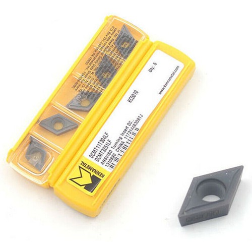

KC5010 is the grade of the insert. It determines its wear characteristics. The geometry determines how it cuts and breaks chips. For doing barrel work on our small machines, positive rake with a chip breaker form is needed. CPMT3201LF is my usual od turning insert. CPMT is the shape, 3201 is the size, LF is the style of chip breaker built into the insert.
KC5010 is the grade of coating not the profile. Both profile and coating influences how the insert works.
I use this Kennemetal insert with the KC5010 coating. They will take very small cuts at pretty slow speeds on a manual machine but they are fragile. They were recommended to me by gunsmith Bill Myers years ago who had a friend that worked for Kennemetal at the time. I met him but I don’t recall his name. Bill needed an insert to work with the Ti he was machining at the time for his actions. They work very well on other materials as well.
View attachment 1656699View attachment 1656700

I run them faster than that mainly because my lathe is an easily adjustable variable speed. I can go from a higher speed profiling a tenon to slow speed threading very quickly. I’d have to try them at 300 to see how they do. I don’t doubt they they’d work fine though. I can skim cut a couple of tenths with just a little finger pressure pushing on the tool holder with them.
I’ll add that two coatings that work well for what we do on manual machines are:
Iscar IC908
Kennemetal KC5010
Not every profile with those coatings are going to work but the right profile with those coatings will do well.
No coating generally works well for slow speed machining but the manufacturers quit making many of the profiles in an un-coated version. I used to use an un-coated insert from Iscar that was great but the un-coated was discontinued. That’s where the rep came in and recommended the IC908. It works just as well as the un-coated version did.
