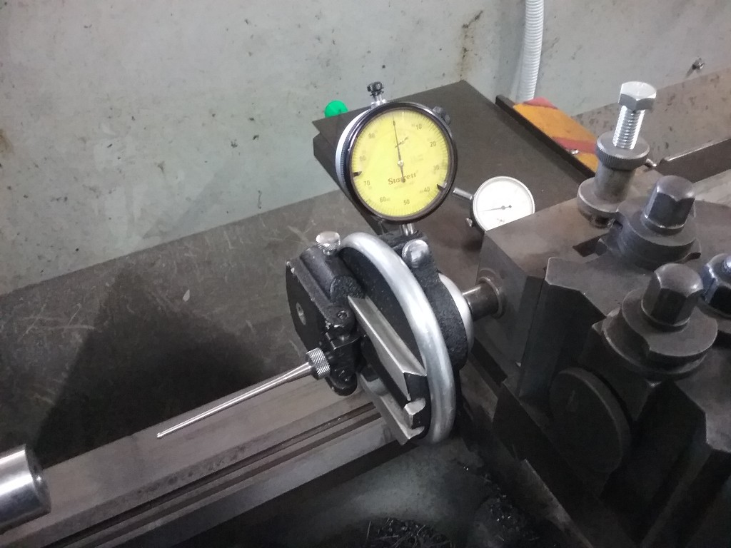

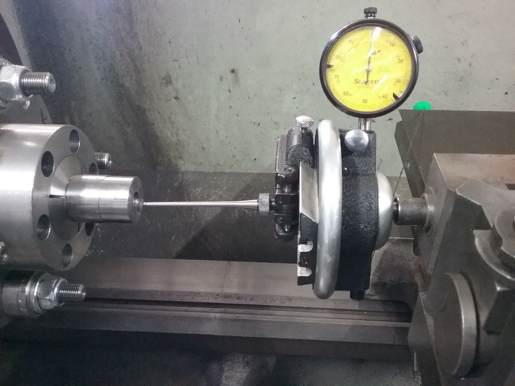

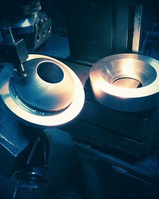

This is the gimballing collet fixture i built, in preference to the more conventional dual spiders setup.
My logic behind it being that i wanted the most rigidity acheivable, & have the angular adjustment seperate of the clamping function - where as with a spider, you are constantly trying to balance screw pressures between sufficient clamping force, bringing the throat/leade area of the bore into alignment with your spindle, and all without unduly deflecting the barrel.
Just figured this to be the best practice solution i could come up with, short of splashing out on a cnc mill, helical interpolation & live tooling. Seems to be working well so far.
The collet nose can be changed out & I fit a "universal action attachment" in its place for truing work, on non cylindrical actions. The first action trued in this fixture was a Ross 1905, ;)

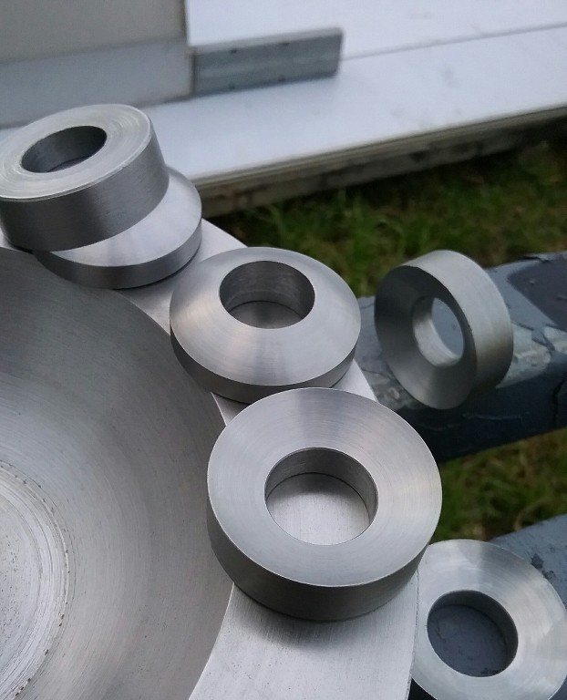

I like to minimize machining of cast iron because the abrasive dust gets everywhere. I make mine with a cast iron back plate, an aluminum ring bolted and interference pinned onto the plate with 1/2-20 set screws with brass tips. I use aluminum because I have a 4' section of 5" diameter aluminum left over from another project. Steel would be fine too but the aluminum in this application is plenty strong. It won't move. 6061 aluminum has the same yield strength as hot rolled steel.
I'll try to remember to take a photo. I think the pins are a pretty good plan to make sure nothing ever moves.
