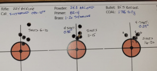

Very early on, with a light load, the gun shot 0.3" at 127 yards. I was at Stan's house when I shot it. :( I then tried to increase the powder charge, but was never able to get much below 0.75".... I even repeated that light load and it grouped poorly.
In all this, I never did proper chamber / carbon ring cleaning....so....
So how does this rifle shoot now?

UPDATE: (after cleaning carbon ring) 224 Valkyrie bolt gun, 100 yds, light winds. Much more what I'm accustomed to this gun doing. Last 2 groups were end of the day, having vision clarity problems, some laziness etc. There still seems to be a bit darker bore from the start of the rifling to 5" down the tube, so more work to do, I think.
