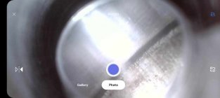

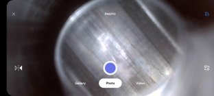

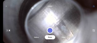

So I got the cheapest Teslong, not expectin g much but pleasantly surprised..... and horrified.... ;)
Some pics .... 6 Dasher, the one I been having problems with, now thinking it wasn't me, it was carbn ring the whole time. Some 400 rounds thru it w/o scrubbing the chamber....till now. Pics are AFTER cleaning.
First.... case neck area from 7 - 2pm, the case mouth "line" and start of the l&g....
Second.... case mouth / where carbon ring forms....10 - 11 am, freebore and comparatively dirty l&g....
Third....dirty l&g from 1 - 8" inches into the bore from the chamber area....
Fourth.... l&g area 8+" from the chamber to the muzzle...
Far as I can tell...
(1) Carbon ring looks minimal AFTER cleaning
(2) From freebore to 8" out needs somer work
(3) 8+ " to muzzle looks good enuf
Seems well worh tthe $60. Pics decently clear. I know WAY more about my bore than before. I *better* start getting some sub 0.50" groups from this thing.

Would like to hear back how it shoots after cleaning.
The pics appear a little out of focus - the focus can be adjusted by screwing in/out the mirror.
The throat and first few inches doesn't look that dirty to me. It would be interesting to know how it shoots when the barrel looks like it does in the pics.
When you finish shooting run a patch of carbon solvent in the throat and first 8" of the bore back and forth ~10x then out the end and it will make cleaning much easier, it helps the prevent the hard carbon ring from forming and makes it way easier to clean. Borescope can tell you a lot of things but don't get wrapped up in it.
I consider the teslong one of the better investments I have made in awhile. If mine stopped working today I figured I had got my moneys worth just for piece of mind knowing whats going on in my barrels. I will admit I was kinda disappointed with pic clarity untill I learned to adjust the mirrior lol...
