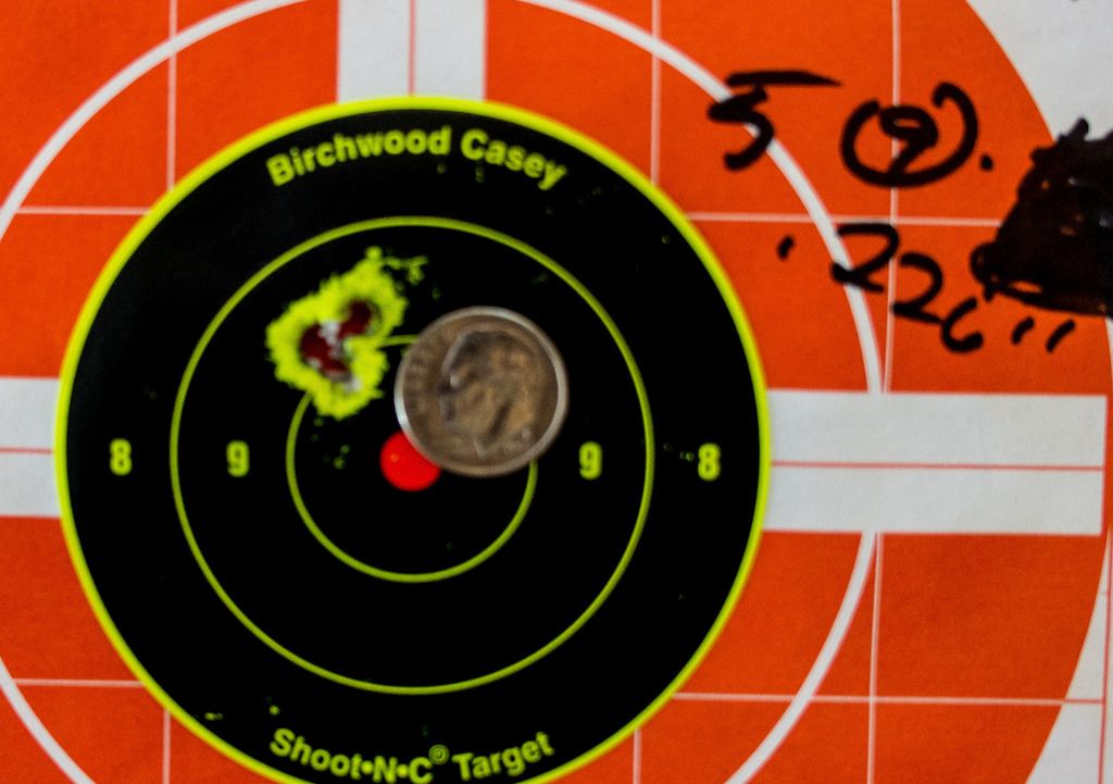

Budget precision build. Criterion 1 in 9 twist , standard Savage short action, Choate Tactical stock. 73 Bergers with Varget. all 5 at 100 yds.

some pics
I've kind of been off an on this project but have managed a great 69 SMK load with Lapua brass, H322 and a BR4 primer. 23.6 grains, book max in the Sierra Manual.
First pic is 3 shot groups finding powder charge and the second pics hard to make out but that's 4 shots, scope POI was off for this round but that 1 flier I know I jerked near the bull and a 3 shot in 1 hole to the left. That's probably my best group ever with anything.
This .223 is something I put together from spare and used parts. I couldn't find any factory ammo it liked so went to the bench and it's the easiest rifle I have to load for.
I may try to go heavier on the bullet yet. It's hard to imagine anything shooting better than this though. Can't wait to try it out on the prarie dogs.
