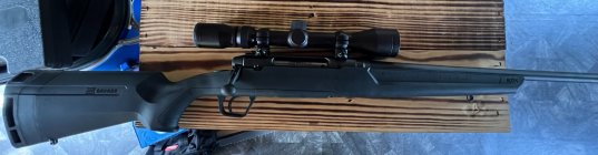

Evening all , I started reloading 7mm08 for a savage axis2 22-inch barrel , using 150 grain nossler BT starline brass and federal #210 large rifle primers ,IMR 4350 powder I am running into an issue and thinking I have to start over load out 1-3 total of 12 rounds with barrel cooling between , (first run) #1 40.5 grains dropped a .81 group of 3 shot 4 was a flyer for a total grouping of 3.38#2 42.5 grains gave me a 1.24 grouping #3 44.5 (MAX) grains grouping was 2.48.Todays shots proved terrible - #1 42.7 grains grouping of 3.39 #2 43 grains grouping of 3 shots 1.81 shot 4 a flyer total grouping of 2.68 #3 43.5 grains grouping of 2.10.
I did try bl-c 2 powder at 39.5 grains grouping of 1.99+/- #2 41.5 grains (MAX) 1.77 grouping with a 2 in 1 (2 shots through the relatively the same hole.
My question is do I start over with IMR4350 and go .5 grain at a time as well as work with or bl-c2?
Again N00B here
Thanks
Kevin

Is the stock making contact with the barrel????????
I'm trying to help you be a successful hunter, shooter, reloader!!!
I believe you are experiencing some problems I had with my synthetic stocks!!
I know how to make the situation better possibly!!!
The rifle is salvageable!!!!
Lets examine the solution one step at a time!!! 1st step: dollar bill test!!!!

He is right here! The only reason I replaced the stock was the gun was beating me up!

Sorry I was at the range with a different rifle , I can slide a 20 dollar bill from the end of the stock to the/and under the end of the scope with zero binding and back again
That is good news!!!
I've been thinking about other causes and have several questions!!!
1. Did you use the lead sled for that different rifle, and did you have any issued with that rifle???
2. Is your scope securely fastened down???
3. Does your scope have parallax adjustment and if so, was it adjusted and checked for the range to the target????
4. Do you know how to check to make sure the parallax is adjusted properly???
Need to start the elimination process!!! The lead sled, no lose scope rings or mounts, properly adjusted parallax!!
If these are not a problem, the flexing of the stock is possibly causing the strings!!!
