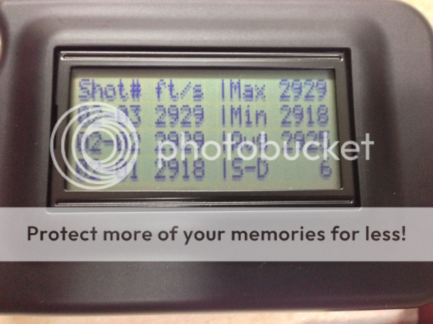

The 180's grouped better at 2925
The RL-17 can get serious velocity
I reached 2990 fps but SD and Accuracy suffered
I settled on 2925 fps for my load.

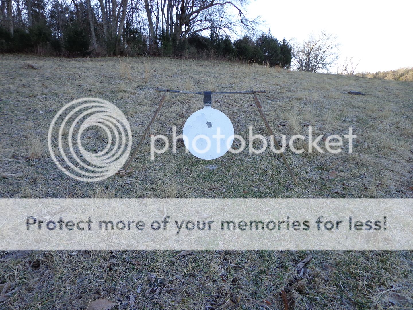

James Phillips and Shayne Halliburton came over Tuesday p.m. and we shot 1500 yards
and 1800 yards.
James had a 300 Win Mag.
I shot my 284 with 180 Hybrids.
I hit the 1500 yard 18 in plate on the 2nd shot. Then Shayne shot it and he hit on the 5 th shot.
Then James went 2 for 5 with the 284.
Here are the 4 shots on target. The 5 th shot is a 300 WM hit. It is the lowest shot.

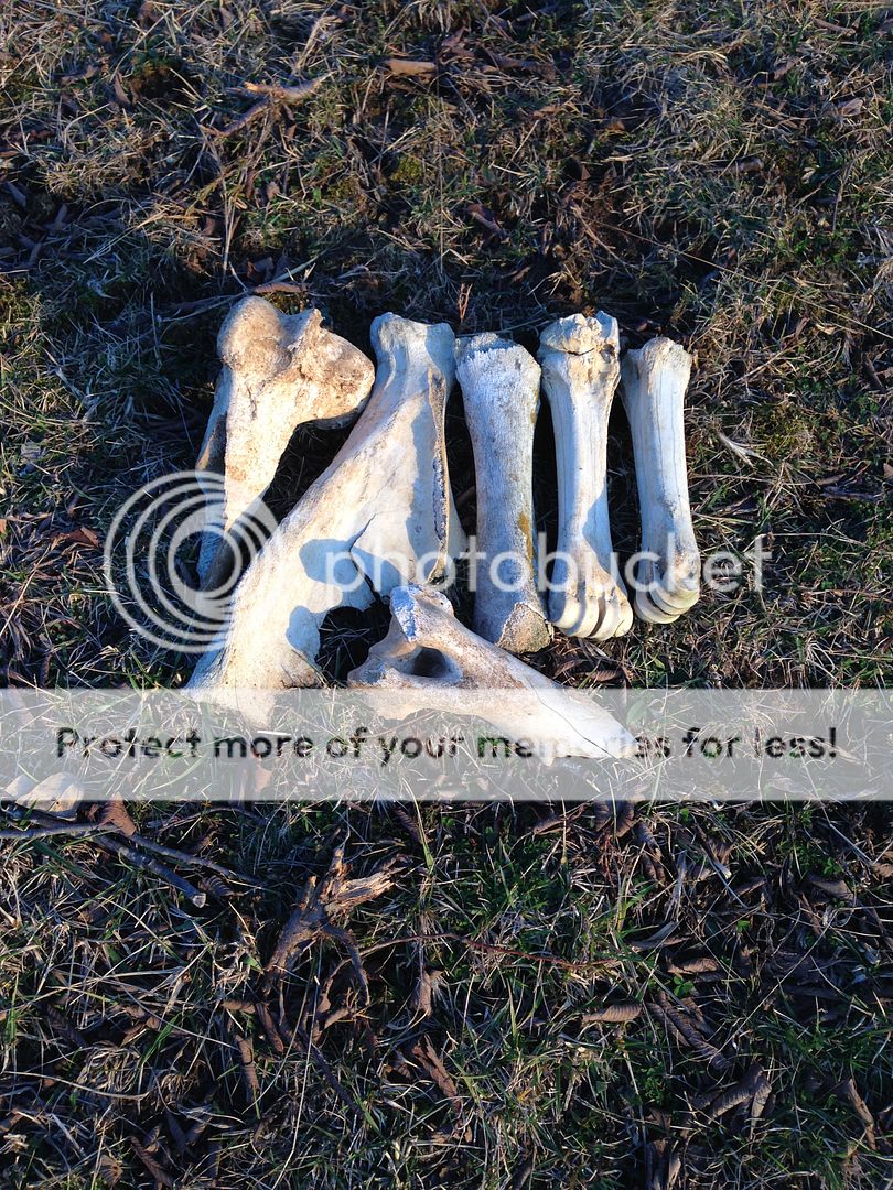

We then moved to 1800 yds and shot at a pile of cow bones.
On my 7 th shot I deleted the right bone.
There was one shot that I did not see dirt fly and I think it may
be another hit in the clavicle that just punched a hole through
the thin bone.
Here is a pic after shots were fired
Here are the bones before the shots with no hole in the clavicle
