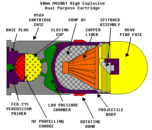

What is the BC on the Mk 19???
Probably not very good:
