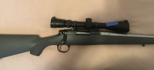

I'm about to put the finishing touches to a similar build in a few days. I hope to shoot it later today. It's a post 64 m70 built from parts I've gathered over a few years. The stock is a nice AA walnut Accurate Innovations stock. I put a stainless bbl on it but now I'm wishing I had done cm and blued it. I might do a black oxide finish on it and see how it turns out. I'll try to post pics later. I had an old Canjar m70 trigger laying around, so it finally found a good home on this one.
Just one pic and it's not very good but I'll post it.
The good news is, it's a half inch gun with very little effort.
The bad news is I'm short on speed before getting pressure signs.
Might try a different powder but for now, I'm gonna find a deer to try it out on.
