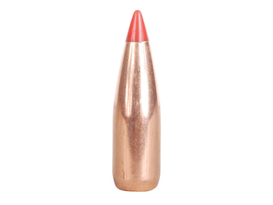

Go to the Hornaday 68gr bthp. Just a suggestion. In September my buddy aired a coyote out at 250 yards with a 53vmax out of my .223 while we were on prairie dog trip.
Those 53gr Vmax are one of my favorite coyote bullets I shoot them out of my 9tw 223AI and 12tw 22-250.
Coyotes are not that tough, I've killed a few hundred now, heaviest bullet I ever used was 60gr Sierra. The 60gr Sierra out of a 223 just isn't going fast enough for reliable expansion. I tried many bullets over the years, once I settled on the 55gr vmax at 3050fps, I stopped looking. I save fur, for that they are the best I found for coyotes, but my fur buyer complained about the 22 cal entrance hole. Now all I use if saving fur is 17-223 with a 25gr. Even with a poor hit, a 55gr vmax will stop them long enough for a second shot.
