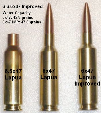

I was looking to barrel a 6xc but the brass availability made me think for just a second, "How about I called Dave Kiff and ask for a 6x47 with some blowout and might as well give it a 35 or 40 degree shoulder?" Well I guess that's called a 6 Long Dasher
I've got the print from PTG but wanted to know how you guys have handled the fireforming (no special process, jam fireform, false shoulder) or how you would do it.
