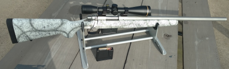

this is a Zastava mini that has a 6x45 chambered barrel on it. Its a nice"walking around rifle built a couple years ago. Stock is English walnut with ebony tip and cap.shoots groups under 7/8" consistently. rifle also has a Kepplinger single set trigger20250326_103630.jpg
