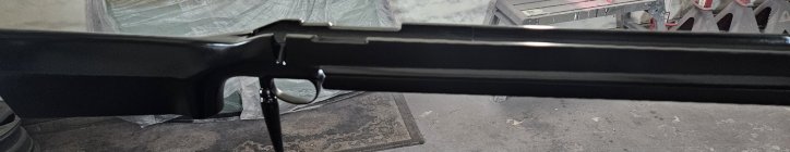

That's actually the last coat of primer, and the bodywork isn't heavy. I weighed the stock as new 747 grams
After sanding I removed 6 grams of gelcoat masked off bedding for loading port repairs.
After putty was blocked out
Stock with masking tape weighed 750 grams.20231203_163827.jpg20231203_163842.jpg

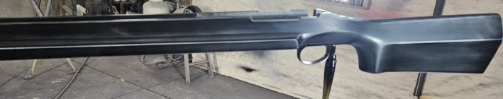

Here's the stock After bodywork and 1st priming with polyester primer.
Stock is definitely in the right hands to get it done right. He leaves no stone unturned with his work. Pics of his paint look really good but up close and personal you have to conclude it's a masterpiece.

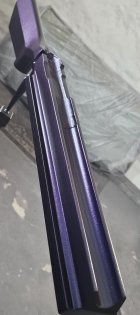

41 gram gain in weight all prepped ready 20231213_164503.jpg1st coat of base knocked back, looks pretty cool20231213_174230.jpgno sealer on this 1 I gotta watch my weight. 2 more coats of black sprayed to perfection so it doesn't distort the chameleon/candy mid coat.
20231213_175548.jpgtime to grab a beer n git jiggy wit it..20231213_183153.jpg
