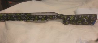

I know you got to thank inflation. I was goin to go with unpainted flat top and have it painted.
The extra cost haveing to fully inletting it , I said Just buy the basic.
Block the sknot out of the gell coat to help even the highs and lows, pay particular attention to bottom of forend and bottom of butt.

I'm in the process of receiving my 6PPC as well. Actually, the barreled action is ready and waiting on the Master Painter Bc'z to work his magic on my stock. I like the P H bore guides as well.
