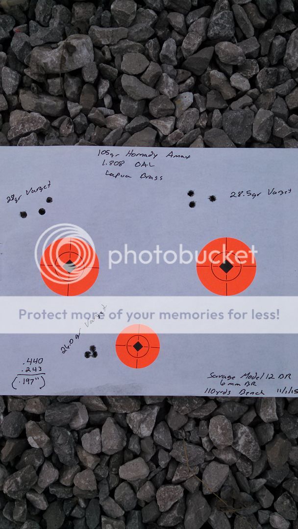

*UPDATE*
Well fellas I made it out back to the range again today an tried out some of those Hornady 105gr Amax. Taking some advice from you guys I loaded these .010 from the lands and tried to use a "free Recoil" technique. Also started the load development back at 100yrds as a few have mentioned I should do. I also did the action torque procedure that was listed in the link. At first when I started my groups it was much the same result. A lot of the groups I shot I could get the same or a little better from a few of the ARs I own so needless to say a little frustration set in again. I loaded the 105gr Hornadys over Varget from 26.5, 27, 27.5, 28, 28.5 and shot 3 rounds of each all at 110yrds. In the first pic you notice that the results were less than stellar with the exception on the lower left using 28gr of Varget but I'm assuming pulled the left. Then the last group was just horrid, after I calmed down I went back up the shed an loaded 3 more of 28, 28.5, and for just grins I decided to try 26gr even. As you can see from the middle group on the last pic that was using 26gr of Varget ( I'm very happy with that. I'm assuming that's what I should be expecting at 100yrds with a proper load from this rifle? One thing I did notice is my front rest, as some of you mentioned it could be a problem. I noticed that with the stock sitting in it, it sit at some what canted to the side and I had to keep pressing one side down to get it level and try and repeat the shot (so yea Ill be upgrading to a better rest very shortly and see if that helps with the overall group size). So do you guys think I should try working with this bullet powder combo(26gr Varget) a little more and push it out to 200yrds an see what it will do or should I go a different route? Also should I be cleaning the rifle barrel or should I just let it be ( other than running a lightly oiled patch through the barrel when I first took it from the box I haven't touched it)? Thanks fellas, all the advice has been a big help!!!!!!
First off, I guess I did not recall Lapua is a 50 round box. Even though it's some time ago I can't believe I bought a 50 round box, but..... I did not start with empty brass, so whatever the amount was I bought it.....should have stuck in my mind.
Cleaning the barrel.....I clean it when I come home when I'm done shooting. Even though my 100 yard range is in my yard I'm not dragging the cleaning stuff outside. I won't get into a barrel cleaning debate with anyone, just saying what I do. And Varget is filthy.
Are you saying your rifle is canted because of the rest? If you are applying pressure on the rifle to straighten it....no good. Lay a towel on the rest or something to make it sit straight by itself....no pressure anywhere.( except your shoulder). How are you judging that it is canted? By the reticle? Is the scope mounted carefully with the reticle square? Meaning matched against a hanging string and the elevation cross hair is perfect? I seem to spend more time than most in lining a scope up as the very best I can.
Finally I would take the pain and spring for the Lapua ammo. That nice 3 shot group you shot I feel would be a 5 shot group with the factory stuff, until you work out a good load for YOUR rifle it will give you (I feel) an interesting goal. I see NO reason to go beyond your 100 yards (and a few why you shouldn't) until that group is smaller and repeatable.
Everything I have said is 100% anecdotal evidence based on my personal experience with zero scientific testing.
You should clean the barrel well. If I'm understanding right. As of now there's quite a few rounds fired Maybe over a hundred. I would clean well with some sweets or other type of copper remover and brush well. Nylon if you prefer. I use bronze. Don't want to touch off a huge hijack about brushing. A factory barrel will strip copper for a while until the lead gets worn in a little. If it's not removed it will build on top of itself and get worse
The 26gr load looks better. But is a light charge.
I think for the amount of powder and bullets shot you could have done a nice seating depth test. As of now you don't really know any more than before you shot this target.

I guess I should have said my average outing for a day of shooting this rifle is maybe 35-40 rounds tops. Then it is cleaned. And like you, Tim, I do not (will not) contribute as to how to clean. I did not realize he had 100 down the tube.
What kind of seating depth teat should I run? It did seem moving back off the lands helped. As far as the canted problem yes its the rest cause its not sitting perfectly flat. Ok I'll keep working at 100yrds an see of I can get some repeatability out of it. I currently have 92rds through the rifle.
