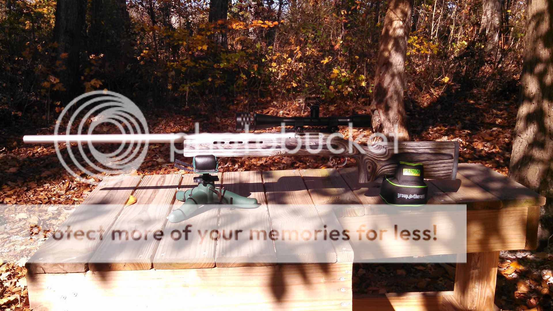

Here is the rifle in question...

Is the bench solid? Is the front rest solid? From looking at the pictures the front rest looks flimsy. I would try another scope if the problem persists. Those groups like what Tim says. I think it is mechanical. Let someone else shoot a group to see if it gets better. Matt

Yea my benches are 4x6 construction concreted into the ground. May be the front rest its a cheap Caldwell with one of their "wide" bags, that's not very wide, perhaps that could be an issue. Worst comes to worst Ill put that scope on a different rifle to test it out an see what happens. Thanks for your reply!
