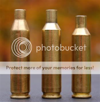

6mm LSI
looking for info
whose got reamers etc
hoping this formed by pushing neck back ala 6SLR
any info would a great help
thanx
6mm LSI shown with 6xc
40' shoulder, .350 neck
Thinking a 6.5x47AI body die would work to form brass, anyone know where i can get one?

Now looking photo i would suggest the shoulder has been pushed back hence the long neck, blowing forward ala AI wud reduce neck
