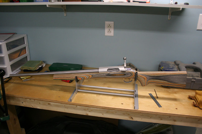

Here is what I have so far...still needs bedded, cleared and glued yet. Its getting there...

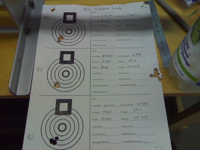

First off, the cases are expanded using a 6mm K&M expandiron and the necks are turned down the fit the chamber. The trial and error part was obtaining the depth. Jim took the bolt apart to get a better feel how the case fit the gun. You need a nice snug fit at the false shoulder. After the neck turner is set, you are golden. The process took quite some time. The turned part of the neck is then sized with the dasher die, nothing else. Other misc brass prep can be done such as squaring the primer pocket, uniform flash hole and taper the inside of the neck with a K&M vld reamer.
We loaded 29gr of varget and a Berger 105 VLD bullet. The bullet is jammed...I 'think' .020'.
Fire and then out comes a sweet looking case!

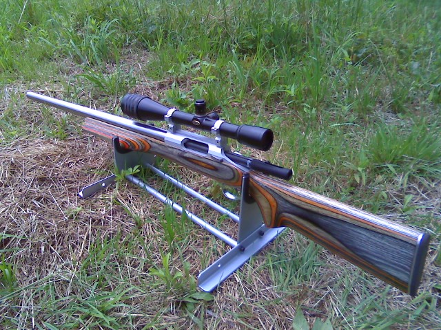

Its been awhile, but the Dasher is all finished. The only rounds out of the gun are fire forming loads only. The agg in the center of the target is 5 rounds and measures 0.168'! I hope I can find a load with formed Dasher cases that shoots in the ones!
Anyhow, here are the crappy phone pics...
