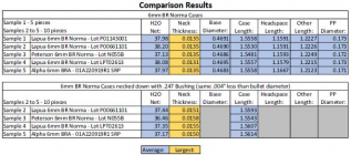

This with a .274 nk
View attachment 1462717View attachment 1462718
The newer Lapua necks might just surprise you
CW
Thanks for posting this Clay, that's an eye opener. Now I've got to check what I have on hand. I don't mind turning necks for competition rifles but was looking for the easy button for a basic 6mmBR with an off the shelf reamer. I may bite the bullet and order a custom no turn reamer.

Lapua 6BR brass (2022) out of the box with a Berger 108 @ pressure ring; OD measures .269.
