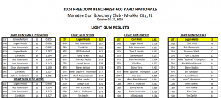

One thing I’ve learned is chasing BC when accuracy is your priority is the wrong choice. As a benchrest shooter I’ve tried it looking for an edge, at the end of the day, it usually doesn’t pan out. Most people are speaking so highly of the 108 bt and 105 hybrids for good reason. I’d stick with those if possible in my opinion. Not saying you can’t get another bullet to shoot better sometimes but overall they are hard to beat and kind of an easy button. 108’s like a little jam and hybrids like a little jump for me. I agg’d 1.7” at 600 yards for 8 targets at the freedom nationals last year using 108 BT not even sorted. I plan on sticking with them.
fantastic shooting!
