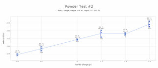

Finally back on the range after some shoulder surgery and a ton of Physical Therapy. Trying out the Berger 105 so ran a quick couple powder test to test the shoulder and a new bipod and scope. All seated at jam minus .020. All I had access to was 100 yards to knock off my rust and get some numbers.
Part of me wants to load up at 31.3 but the high(er) SD/ES and the vertical isnt the same scares me a bit... Feel free to drop me your thoughts. Spending this year going slow and learning everything I can.

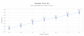

Below is the first Powder test as well for .3 jumps.

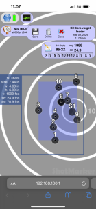

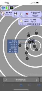

600 yards…..Varget ladder, 31.1 to 31.9 gr, 2 shots each, 103 VT +6, BR-4 (7 thou under rim) Peterson, 265 bu, 267 ld nk, no annealing, still under 100 rounds on standard bart HV bbl
Had pressure at 31.9 gr
5 and 6 are 31.5 gr stacked in each other and was 2962 fps this day
This is a new reamer that I combined from sam hall (463 shoulder) and Wheeler standard bra reamer, Old dominion chambered
Around 2960 with varget is where I've seen good stuff happen.
