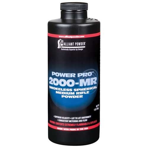

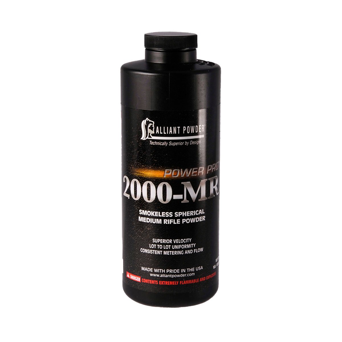

i am just glad that i have 9 lbs of the 2000MR.. cuz it is unobtainum right now
8 pounders in stock
