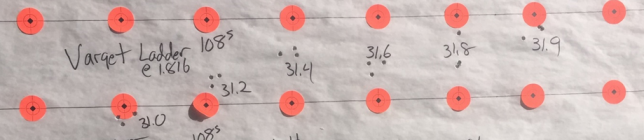

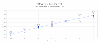

Newbie question... Shot a quick powder charge test at 100 yards. 6BRA, Krieger 28 inch, Varget, Berger 108btm, lapua 1x fired brass. Each group went up in 0.3 and shot them all round robin style (first time trying that). Didnt see any real flat spots in the numbers and the last shot from the last two groups (31.0 and 31.3) went way up in velocity. Gave about two minutes before firings and a couple blow offs when the range went cold. Thinking about retesting the upper node from 31.0 - 31.6 (no pressure signs at 31.3) with a .2 step and five shot groups. Any thoughts there?

Ignore the velocity and try to shoot at further distance. Keep all your targets on a horizontal plane. Retest 30.7 thru 31.5 in .2gr increments. I'll bet your rifle will like it somewhere around 31.2-31.5gr
Thanks for the assist. I’ll give that a whirl at 600 this weekend. Appreciate the help
