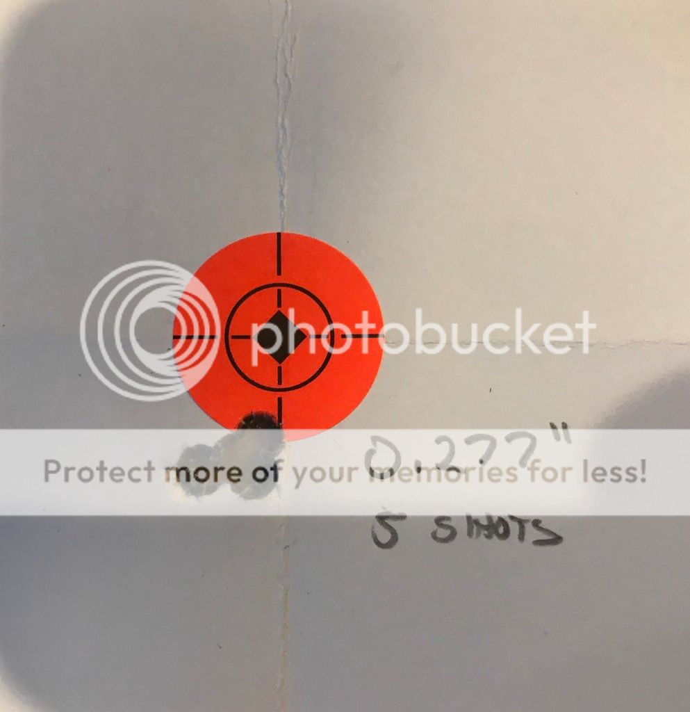

I had a few rounds left from yesterday's 300 yard match and the weather was completely different today, so I shot a 5-shot group at 200 yards. The temperature today was very warm and unlike yesterday there was bright sunshine. The wind was a headwind from about 10 to 12 o'clock and varied from 5 to 10 mph. I was pleasantly surprised at the accuracy obtained today. PS- The barrel is a 28" Brux 4-groove cut rifling in 8 twist. The rifle is a BAT B with Terry Leonard stock and 36X Valdada scope.

This looks like a pretty good fire forming load for me. Maybe one that I could actually shoot in a match
30.0g Varget, 105 Hybrid, Rem 7 1/2 primer, 0.010 jam

Are you referring to the above group? That is for fire forming to the 40 degree shoulder. You cant get the velocity or much more powder in there before hitting pressure, while fire forming. They are definitely accurate while forming. Though afterwards they usually can hit dasher speeds without issue.
