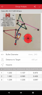

My bra barrel is going be on its way out shortly with 2800 rounds on it, so threw the new barrel on to fireform some brass and break it in. Slapped a random charge of varget in and zeroed at 100 then took it to 550 for some drop verification. Love this caliber

600 yards 6 BRA 103 VT Lapua on 12th firing and a 400 primer H4895
