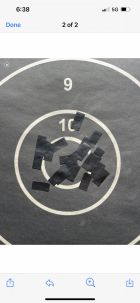

Reloder 15.5 is performing well in my bra. 31.6 grns alpha brass Cci 450 with 105 hybrid. In a 30 inch 8 twist barrel velocity is around 2930. First 600 hundred yard match it shot 599-38 which was good enough for second. Posted final relay target which was a 200-15 and the only clean on the final relay
