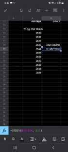

I'm load testing Match Rifle with 107's in my rifle (28" barrel) right now. I'm shooting 29.3 grains in Peterson brass with cci 450's. Results look promising so far. In the attached Chrono numbers, the slowest shot was the first on in the string after mounting the magneetospeed. After that it settled in nicely. I've also attached a target from seating depth testing (100 yards). I have loaded up some more at that depth (.005 into the lands) to see if the flyer is potentially me.
