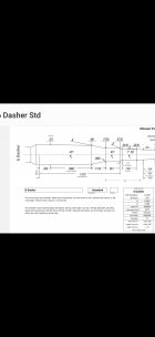

I avoided norma brass due to the notes on my reamer print. It noted norma brass needed .303 neck length. Anyone seen this or have issues from it?

It’s preferable to use the Norma Dasher reamer if your going to use the the Norma brass. And you have to trim .050” off the neck to use it in a Lapua Dasher chamber.

The neck on the NORMA 6 Dasher brass is .050" longer than a neck on Lapua 6BR case fire formed into a Lapua Dasher, if you use the Norma 6 dasher brass in a Lapua Dasher chamber you need to trim the Norma brass necks approx. .050" in OAL.
