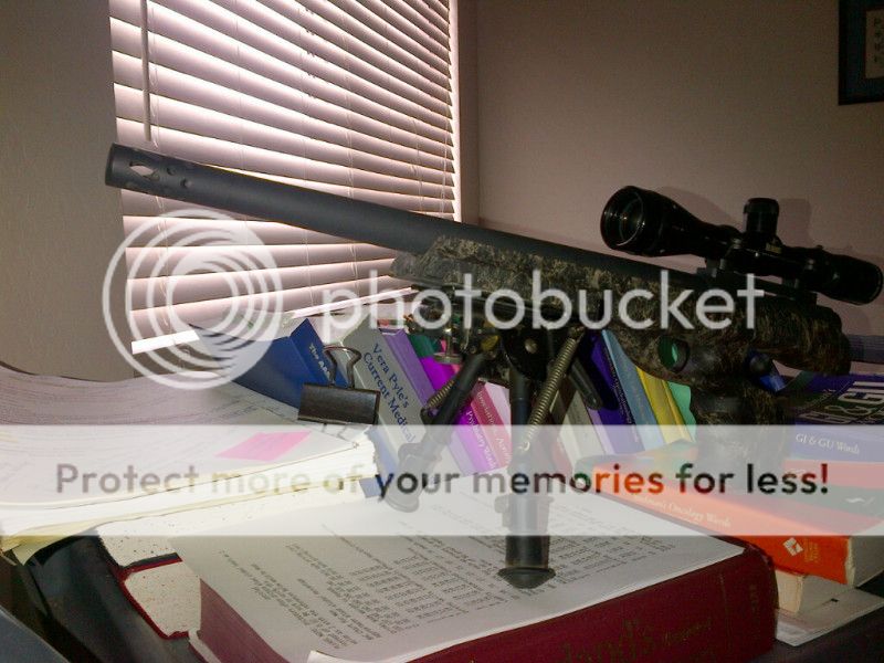

Don't own any rear grips anymore, all of mine are center grip , here is my latest, a 6.5x284 HS Precision heavy barrel (15" + brake). Does just fine with 120-130 gr ballistic tip and accubonds. this is used on the bench and in the field. I know several others are running 16"-18" barrels (and longer) on their rear grip handcannons
