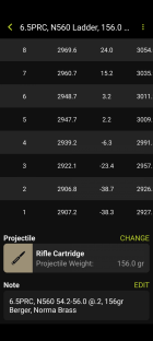

I shot an initial work up a few weeks back in my Bergara HMR Pro 26", and began to question my results. The group wasn't as good as I expected. My ladder was N560 @51.5-56.0 in .5gr increments yielding a velocity range from 2749 to 2955 fps. I did not see any pressure signs at the higher charge weights, but the grouping got better despite not seeing a velocity node on my chart. So I ask, for the 156 Berger is N560 too fast of a powder? And what velocities should I expect from a 156gr Berger in a 26" pipe?

FeMan, you're probably right. Nice shot groups you have. I'm not sure I can see well enough to achieve that but that is my goal. Tight groups. I'm probably not using the right terminology and for my interpretation of a true ladder test or ocw for that matter I should be testing at further ranges than what I had available. I do look at target data 1st, but I try to correlate bullet impacts with said velocity for each respective shot. I'm not a seasoned loader by any means of the imagination so that's why I'm posting for feedback. I inserted my sheet in the 1st post for review. Maybe I did pass through one or more nodes and based on my target and the Chrono numbers I am going to look at a tighter charge weight say .2gr or . 3gr increments from 54.5 to 56 and probably up to 57 or pressure signs, whichever comes first. I seated at 2.261" from ogive, 2.952 coal because of magazine restrictions. I also will move down to a .290 bushing because on some of my Accubond tests on twice fired Norma brass, I did not have enough neck tension. I posted another thread about that. What is a realistic velocity for the 156 in a 26" barrel. I think 3000 is possible before I reach pressure, but I'm plenty satisfied with 2950-2975.

Looking at your target in the spreadsheet, with velocities, loads 4,5,6 are where you should explore more. Very little vertical dispersion on target. 4 & 5 were very close in velocity, however with 6 printing very close vertically, that leaves you some room to allow temperature variation in the summer.
I agree with Fast14riot. If there is a place to look, its in the range of 4 to 6.
One thing though is your combined group is wider than it is tall. That is a red flag and might suggest that your seating depth is not near optimal or probably more likely, that your rifle does not like the powder. Below is a powder ladder I shot with a 300 Norma at 800 yards. It illustrates the shape you want to see (tall and narrow).

That could be me, too, lol. So, when I loaded these, I was leaving my farm to come home the next day and was on a time crunch. I just dropped a quick ladder and stuffed them to 2.95". I just loaded 10 more today but at a .2gr increment from 54.2gr-56.0gr and seated as long as I felt would be reliably feed from my magazine at 2.98" overall length. I could load them longer, but I would have to chamber them by hand so I won't even see how those would shoot. I also went down in size on my neck sizing bushing from a .292" to a .290" because I seemed to have some inconsistent neck tension on some Accubond loads I shot that day from the same brass. Looking at pressure tattletales, I may not make the last shots since I changed the seating depth, but I'll see. Also looking at my 6,7,8, and 9 shots, I got a .63moa 4 shot group and it is in a velocity range I want. When I test these out again, I'll revisit with my results

Well I finally had a chance to shoot this load yesterday. Considering I was shooting in 15-20 mph winds I'm impressed with the results but I started getting ejector marks on the last 3 or 4 shots. I'm pretty sure 55.0gr will be my load. I'll do another verification test and post when I get a chance.1000005366.png1000005369.pngWell1000005355.jpg
