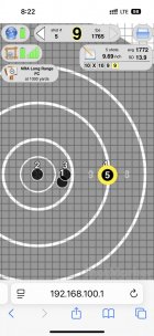

I just shot a 5 shot group with my 284 at 1060 yards that had 1” of vertical. The brass was not annealed. The annealed shot 5” of vertical. Neck tension matters too!

My latest 1060 yard ladder was shot with Lapua brass. Here is the target. FWIW, there was a switchy tail wind and I held the same for all five shots. Just looking for vertical here. The grid overlay is 1-inch
